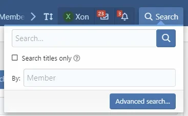

I'ld probably put it behind a style property, but frankly a search icon on the end after the area selector would work a lot better than the current solution.
:edit: I might release it as a template modification in a standalone add-on as the template modification to implement this is kinda hairy and making it conditional would be fairly complicated over just making it a trivially small add-on
I like your suggestion, but I was specifically talking about the linked comment, not the OP.
IE:
Relatedly, "show results as threads" is arguably the most important "advanced option", so I think it deserves its own checkbox next to "search titles only".
An alternative is to have an easy option to "show results as threads" on the search results page.

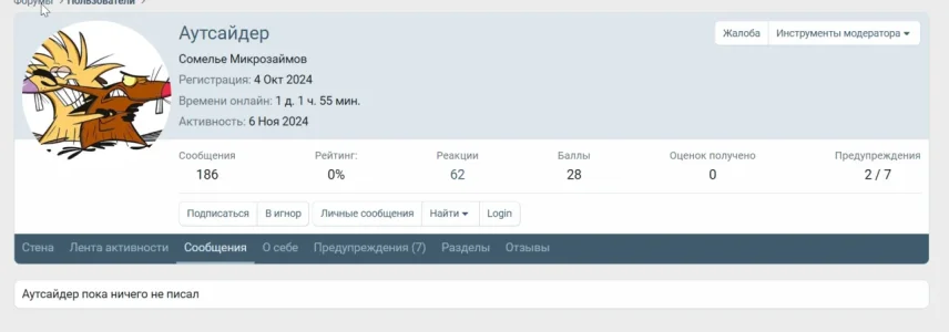

also having issue with search by user when user have posts but search shows nothing
(example https://findozor.net/forum/members/autsajder.24488/)
xenforo 2.2.16
searche improvements 2.16.1
ElasticSearch Essentials 3.16.5
XenForo Enhanced Search 2.2.2
Someone turned on the "Log search DSL" option, which is dumping the search query into the XF error log
Check the number of documents in elasticsearch (elasticsearch setup page shows it) is the same or greater than the number of posts. If someone reset the search index it'll be much lower than you expect and you'll need to re-index the site.
