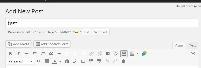

Even in WP that i also use this option exists by default

XenForo and WP are very different targets and use cases. If you really want to customize specific URLs though, you can look at using route filters to change them.
