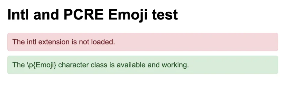

I have a setup without intl and the Emoji class is available.
We've also had no other reports of this. We've had other reports related to intl not being available, but nothing related to this, which they would have run into.
Test script:

</html>
