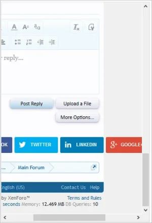

Actually the top one shows right only if the bottom one is enabled. If I use only top one (or only bottom), it shows the same as I've posted above.
Yes, that's the strange anomaly. If you add more instances of the code it's always the final instance that doesn't display correctly so if there is only one instance that is obviously the final one.
The js seems not to be applying the classes correctly to that final instance, if you watch the code as you resize the window you will see what I mean.

I also seem to have same issue with inconsistency with the button size when both top and bottom are enabled. On top, one button (FB) is full sized, the rest is minimalized. On bottom, FB and Twitter buttons are full sized, rest is mini.
Yes, as in previous posts this is a known issue and I will seek to find a fix when I have more time.
One workaround would be to add a hidden instance of the code that way the next one or two instances would work fine.

I think I found the issue with the button text wrapping on smaller displays. It is some XF CSS conflicting with the buttons.
add this css to the SV_rrssbDefault.css template and it should fix the issue.
.share-container.clearfix {
    word-wrap: normal;
I'm working on an update with this fix and a few other bits.
I think I found the issue with the buttons not showing correctly.
add this the SV_rrssbDefault.css template and see if that fixes the issue.
    word-wrap: normal;
same result for me.
I have both top and bottom. 45% max width and 300px min width
Sorry my wording should have been better, that css should fix the button text wrapping issue as there was an xenforo css conflict. I updated my post
The button size issue seems to still be present when top and bottom is enabled but for anyone only using the one instance it will be better.
