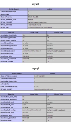

Uh, for one, mysqli can be installed simultaneously with mysql. Second, do you expect the developers to throw their code and better performance away because your infrastructure is dated? Third, this is not "as soon as technology turned," I have been using mysqli for 5+ years. And if technology turned again I don't think XenForo would adopt it until their current customers do.
If you want to run modern software you will need a modern infrastructure. If you have to run an older infrastructure, fine, but you shouldn't expect to use modern software. And any modern software should be making use of mysqli by now.
Edit: Just checked my production server, both mysql and mysqli are loaded, and I've never had to deal with any conflicts because of it.
