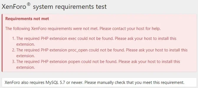

In my case the server running XenForo has additional security installed with a separate ssp.ini settings file that also includes disable_functions.

disable_functions = show_source,system,shell_exec,passthru,exec,popen,proc_open,allow_url_fopen
Even though the XenForo recommended functions of exec, popen and proc_open were disabled in this file. Your current requirements script did not indicate this during its' check.

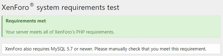

This is what your current xenforo_requirements.php script reported:
After modifying xenforo_requirements.php script...
Removed lines 355-376:

And added these individual function_exists checks:
(fpassthru check was already included in the existing code on line 276)
PHP:
if (!function_exists('ini_set'))
    $errors['ini_set'] = 'The required PHP extension ini_set could not be found. Please ask your host to install this extension.';
if (!function_exists('fsockopen'))
    $errors['fsockopen'] = 'The required PHP extension fsockopen could not be found. Please ask your host to install this extension.';
if (!function_exists('exec'))
    $errors['exec'] = 'The required PHP extension exec could not be found. Please ask your host to install this extension.';
if (!function_exists('escapeshellarg'))
    $errors['escapeshellarg'] = 'The required PHP extension escapeshellarg could not be found. Please ask your host to install this extension.';
if (!function_exists('proc_open'))
    $errors['proc_open'] = 'The required PHP extension proc_open could not be found. Please ask your host to install this extension.';
if (!function_exists('popen'))
    $errors['popen'] = 'The required PHP extension popen could not be found. Please ask your host to install this extension.';
if (!function_exists('set_time_limit'))
    $errors['set_time_limit'] = 'The required PHP extension set_time_limit could not be found. Please ask your host to install this extension.';
I then was able to get an accurate response to the functions being disabled on the server:
