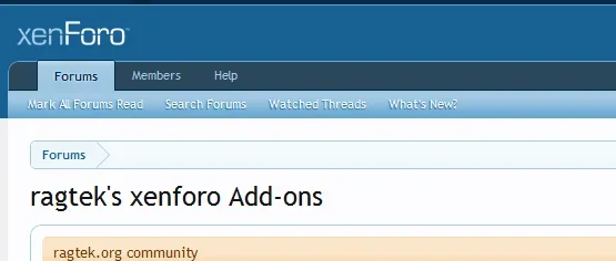

hm, not all left tabs are always public..
Example:

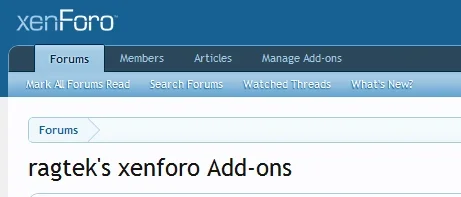

The right side includes IMHO the "private stuff" (user related stuff), but i like the idea of moving the help to footer. (as you see on the screenshot, i've removed it completely for me because it's unnecessary)
To remove the help tab in the navi:
open template navigation
add at top:
<xen:set var="$tabs.help">0</xen:set>
(does anybody know, if it woult be possible to do this with an code event?)
To add it to the footer:
Use the template hook footer_links or footer_links_legal to add it without any template changes

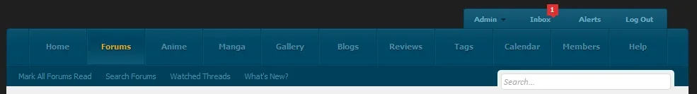

Forsaken
How did you made this?
That's something similar, what we also want to do http://xenforo.com/community/threads/style-problem.10040/
Edited logo_block:
<xen:if is="{$visitor.user_id}">
<link rel="xenforo_template" type="text/html" href="navigation_visitor_tab.html" />
<xen:else />
<div style="height:27px;">&nbsp;</div>
</xen:if>
And then rewrote navigation_visitor_tab.
Ignore the else statement, its there for something else later on.
