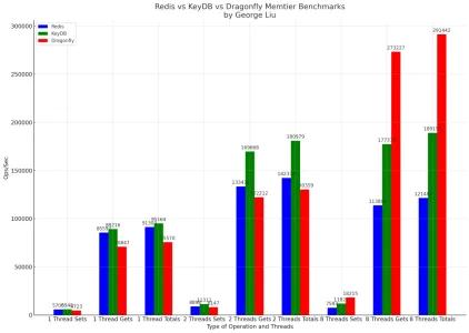

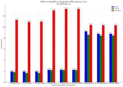

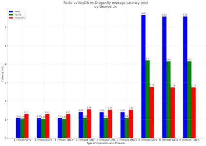

I just tested Redis vs KeyDB vs Dragonfly - all three Redis compatible with memtier benchmark with 1:15 SET:GET ratio and very interesting results :)
Tested on Intel Xeon E-2276G 6C/12T, 32GB, 2x 960GB NVMe software raid 1 AlmaLinux 8 Centmin Mod LEMP stack server :)
Ops/sec
Average latency
99% Percentile latency
I've been keeping my eye out for Dragonfly, but it is disappointing to see such terrible 99% percentile latency statistics. But it is a fairly young project still, but the operational improvements are something that redis badly needs.
There are some outstanding bug reports around latency, so maybe this chart will change soon

How many cpu cores/threads did the server have? How are you measuring the improvement? In terms of latency or ops/sec or Xenforo performance?
Ops/sec
Average latency
Did you use --tcp_nodelay with dragonfly (redis sets this by default) ? Apparently this can help the latency figures

It's by design straight from Dragonfly devs - they designed it for high CPU core counts - most of their benchmarks are with up to 30+ CPU cores IIRC. See https://github.com/dragonflydb/dragonfly/discussions/1688. Basically if you have single or low CPU core counts keep using Redis
not a bug - but a design choice.
we had many questions like these before. @Niennienzz we should probably add a documentation page on how to benchmark Dragonfly so we could just reply with a single link.
TLDR: if you intend to run your memory store locally or using a single thread - please continue using Redis. It has lower latency for a single connection. Also, there are not many performance advantages when running Dragonfly in a single thread. So if this is your use-case - then do not use Dragonfly.
Every implementation has its own best practices.
Dragonfly can not parallelize efficiently workloads when serving a single connection because it needs to respect the order for the incoming requests on that connection. Dragonfly shines when there are multiple client connections. Dozens, hundreds - the more the merrier. Dragonfly also has limits internally of how much pipelining it allows. AFAIK, the factor is 10, meaning pipelining more than the limit won't produce more throughput. The reason for this is that pipelining adds more latency and more memory pressure and again, the best practice with Dragonfly is to parallelize using multiple connections.
Ah I read about that but didn't set it. Will have to retest to see. But Dragonfly results are inline with their devs claims - they've optimised for high CPU core count servers :)
