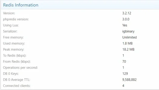

How much speed increase should we expect in page generation times with Redis enabled?
Page load time with redis enabled/disabled is the same, I haven't seen a difference.
Settings are
// setup redis caching
$config['cache']['enabled'] = true;
$config['pagecache']['enabled'] = true;
$config['cache']['provider'] = 'SV\RedisCache\Redis';
// all keys and their defaults
$config['cache']['config'] = array(
'server' => '127.0.0.1',
'port' => 6379,
'timeout' => 2.5,
'persistent' => null,
'force_standalone' => false,
'connect_retries' => 1,
'read_timeout' => null,
'password' => null,
'database' => 0,
'compress_data' => 1,
'lifetimelimit' => 2592000,
'compress_threshold' => 20480,
'compression_lib' => null, // dynamically select first of; snappy,lzf,l4z,gzip IF EMPTY/null
'use_lua' => true,
'serializer' => 'igbinary', // to disable set ot 'php'
'retry_reads_on_master' => false,
// HA support
'load_from_slave' => null, // config entry similar to $config['cache']['config'], except without HA options
'load_from_slaves' => null, // config entry similar to $config['cache']['config'], except without HA options
'sentinel_master_set' => null,
'sentinel_persistent' => null,
So it looks like it is working, but little difference in results with it on or off. Does the config look correct? The settings were copied from one of the examples in the Redis Cache 2.6.2 addon.
