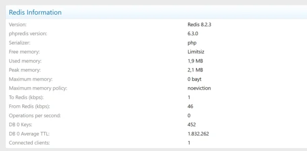

Hello everyone,
Ekran görüntüsü 2025-11-15 151015.webpI have a server running AlmaLinux 10 + DirectAdmin + LiteSpeed.I’ve configured Redis to be used by both WordPress and XenForo, but I want to clarify a few details about the setup. Here’s an overview of my current configuration:
✔ REDIS SETUP ON THE SERVER (DirectAdmin User-Based Redis)​
There is no system-wide Redis installed on the server.
DirectAdmin creates a localized (user-based) Redis instance for each user.
Mine runs through this socket:
/home/admin/.redis/redis.sock
So I’m using a Unix socket instead of a port.
This Redis instance works without issues, and both XenForo and WordPress connect through the same socket.
✔ PHP SIDE (phpredis) STATUS​
To use Redis, the phpredis extension must be active on the PHP side.
  • PHP 8.4 has phpredis enabled → working without issues
  • LiteSpeed is also using PHP 8.4, so WordPress connects properly
  • XenForo shows “phpredis 6.3.0” in the Redis information panel
In other words, phpredis is active for both WordPress and XenForo.
✔ XENFORO CONFIGURATION​
I’m using the RedisCache add-on.
My config is:
$config['cache']['provider'] = 'SV\RedisCache\Redis';
$config['cache']['config'] = [
'server' => 'unix:///home/admin/.redis/redis.sock',
'port' => null,
$config['cache']['namespace'] = 'xf_';
$config['pageCache']['enabled'] = true;
$config['pageCache']['lifetime'] = 300;
The XenForo Redis Information page is fully populated:
  • Redis 8.2.3
  • phpredis 6.3.0
  • Memory / TTL / IOPS metrics look normal
So XenForo is fully using Redis.

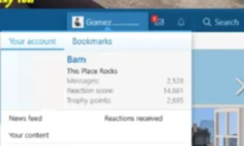

@Xon can you please advise why Redis is displaying the username of other user on the navbar and when you click on it the popup shows the right username?
That is nothing todo with this add-on, you have some sort of webserver side caching which isn't aware of who is logged in.
