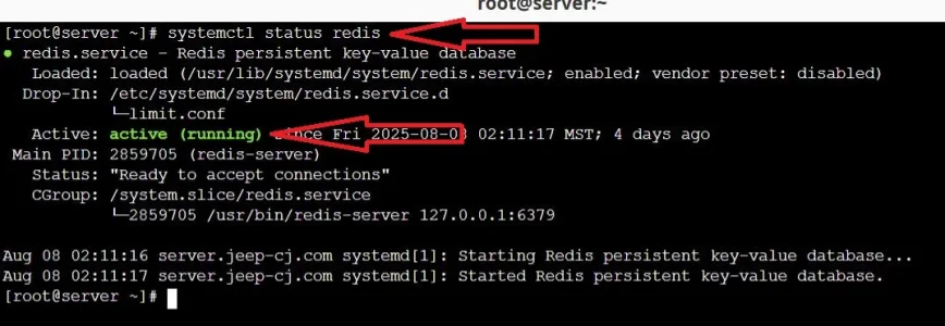

I cant see the redis settings on the ACP main page, its not showing the details even though the installation was done and its all set up as expected.
You need to configure the config.php entry, not just install the add-on for this add-on to work
We use Redis for Wordpress so it’s definitely online and working, it seems it’s functional just doesn’t show the redis data in the ACP.
Check AdminCP => Tools => Redis Info or the /admin.php?redis-info/ URL.
If this shows up, it means there is a template modification conflict which is causing the additions to fail to be shown
This was it :) After much digging around our custom add-ons etc its now working as expected.

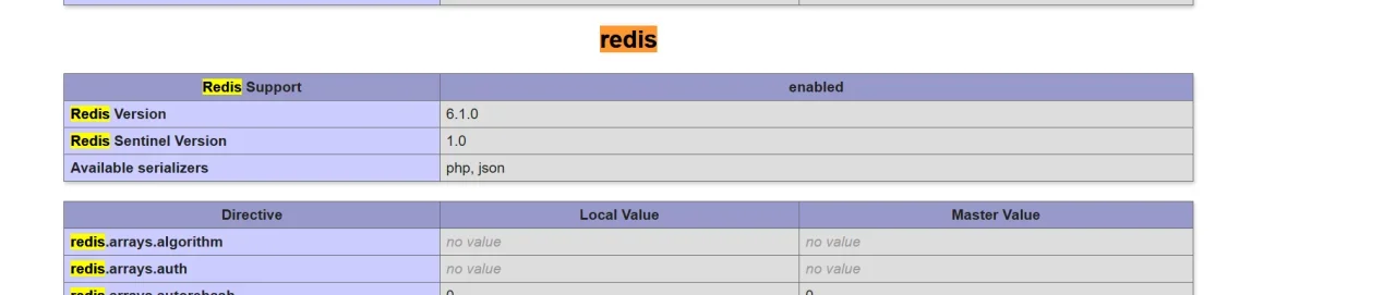

phpredis is better than igbinary
They're completely different things; so one can't really be better than the other. They are both extensions though. Stick with both, one for the layer between php and redis (phpredis), and the other one is an alternate serializer for the data stored inside of redis.
Okay, any config.php recommendations? Should I use php or igbinary as serializer? And I need the best config. Should I use replicas or sentinel etc.
