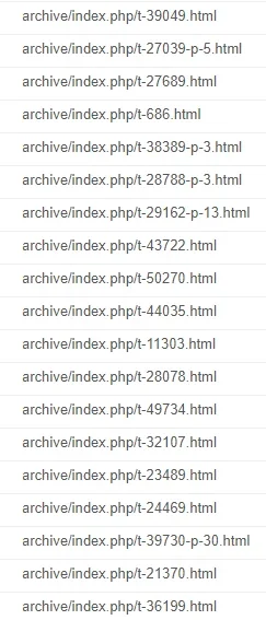

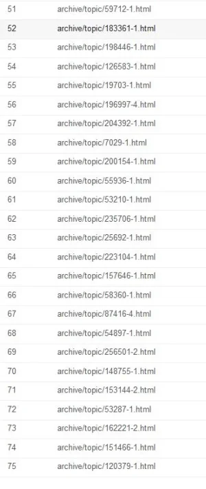

I'm not 100% positive, but those URLs don't look like the standard URLs for the archive stuff, at least for the versions these scripts are covering. You may need to redirect them using .htaccess rules.
Triops
So I'm trying to redirect the /archive/index.php/t-731233.html to the proper thread now...Do I need to set something up special for it?
Same here, all these archive threads are not redirecting, webmaster tools lists thousands and thousands of errors. These should be all valid links from vB3.7 which I used for years before changing to xf.
Could this be related to renaming "threads/" into "thema/" in Xenforo route filters?
