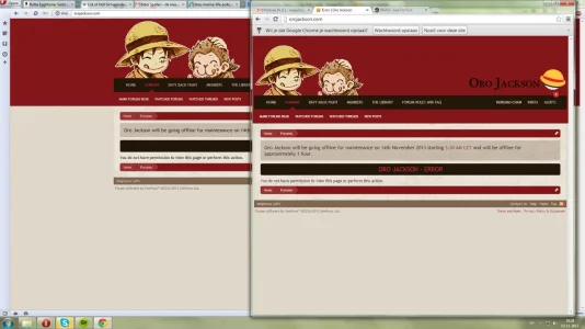

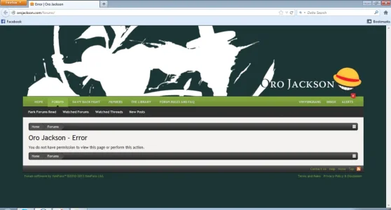

I seem to have a weird problem coming up. One of my members informed me that they cannot access any part of my site all of a sudden (note, it worked fine just 10 minutes back) they get a error regarding permission on ALL pages of the forum.
Error
You do not have the permission to view this page or perform this action.

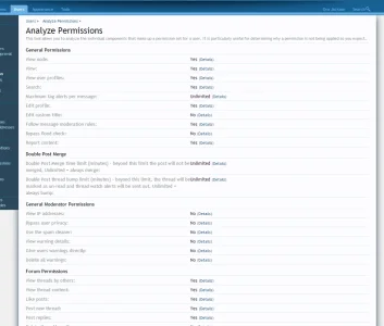

I checked the permissions for the user, everything seems fine. They can also see the board while not logged in. I ran the permission analyzer and it seems to give me a report that the permissions are fine.
So what exactly is the problem here? When I use the "Test Permissions" tool for that user even I get the same error everywhere.

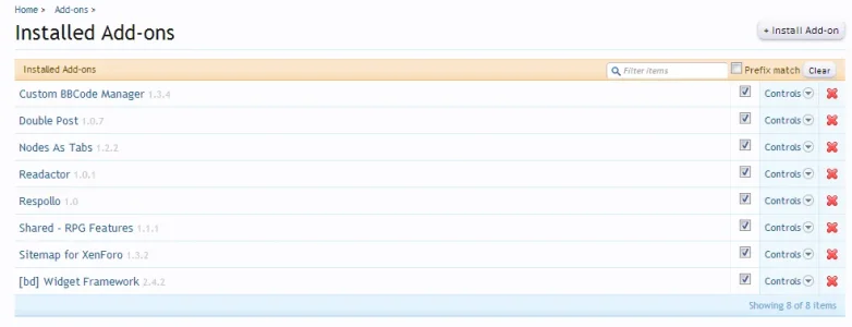

Edit: Just incase @arms or @Eoj Nawoh want to compare add-ons we are running and possibly try to see if any other add-on could also be causing an issue, here's a screenshot of add-ons being used on my board.
Will do :) If the problem replicates and if I come to know/am reported about the issue I'll inform you. Indeed, I don't have your add-on installed! And it's a problematic issue, seems that it can only be looked into when the problem is happening. So far after my first report by the user who was facing this issue, no other such report has come up. I think partially because I set all groups permissions for "view" and "view node" to yes or due to add-on upgrades rebuilding permissions/changes in usergroups rebuilding permissions.
If anything pops up I'll be sure to let you know :)
We have Sitemap, Widget Framework and Nodes as Tabs in common. But if I've read your posts correctly, it seems your issue is a little different. Yours continue upon all addons being disabled. Not to mention, it happens for all pages and everything. While for our issue, it stops when all addons are disabled, or just Steam Auth. It only happens on the first page they click and refreshing removes the problem temporarily.

I'm having this permission error re-occur again, the user was just promoted via the user group promotion and the user gets an error saying on any page visited.
It hasn't occurred (or reported) to me since the last time and just happened now. The user was just promoted to a new group via the user-group promotion, no special permissions and all says yes in permission checks. @Mike should I open a support ticket so you can look into it?
