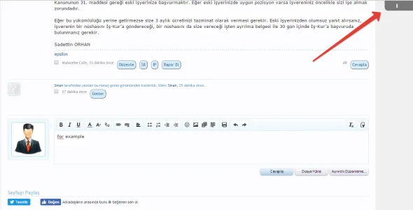

Hello. my forum's quick reply function doesn't work properly in chrome and opera browsers. In firefox there is no problem. I cleaned my browsers cache, I tried different computers, disabled addons, even I have try on my friends but the problem continues.
forum.muhasebecafe.com
When I send something with quickreply, the sending symbol at the top right loading forever. Yes the message was sent but page doesn't refreh itself. I have to refresh the page for see my message. What causes this problem?
