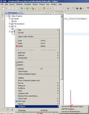

1. It's important that you create a project.
AFAIK the auto complete works only in project, because the IDE needs to know, which classes, methods & vars exists.
2. You have to activate it. As i tried eclipse (pdt), i had some problems with these feature.
After searching for the problem, i saw on a page, that i needed to enable the php support for the project
I'm using PHPStorm & Netbeans, because i can't use PDT on my netbook:( It's too slow^^

SchmitzIT
I did not manage to get this working. The "enable PHP" option is grayed out for me.
I'm running Win7, Eclipse, and XAMP. I started a new project, but am thinking I still somehow need to point the project to the XF framework by adding it to the include path. I'm just not sure what to point it at?
