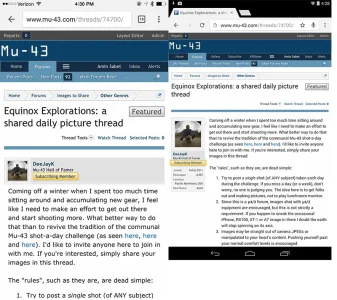

My question relates to how my sites (using mildly customized default XF 1.4 style) render on my phone (iPhone 6 Plus) vs my small tablets (Nexus 7, iPad Mini).
I have read this resource and the accompanying discussion: https://xenforo.com/community/resources/responsive-design.2193/
iPhone 6 Plus renders at 1242 × 2208 pixels
Nexus 7 (later model) renders at 1200 x 1900 pixels
Here is how my site looks on iPhone 6 Plus (left) compared with Nexus 7 (right)
You can see how the avatar and member info are shown above the message text on the phone, and to the left of the message text on the tablet. On the tablet, the message text looks quite small at normal reading distances.
What I'd like is for the small tablets (7" Android tabs, iPad Mini), when used in portrait orientation, to render like a phone. How can I accomplish this?

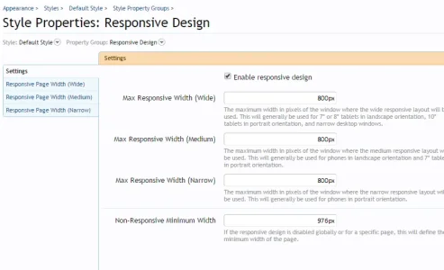

My current trigger point settings are the default 800px/610px/480px/976px. I've tried setting them much higher (1540px/1540px/1540px/1540px), and I've tried setting them lower. No matter what I enter, the Nexus 7 doesn't render like a phone. Can you suggest numbers for me to replace those four numbers with?

In order to get all of these devices to render as desired (with the narrow responsive layout), I had to set Max Responsive Width (Narrow) to "800"
Can anyone explain how the medium responsive layout differs from the wide responsive layout when using the default XenForo 1.4 style? These settings seem to give me the results I wanted:
