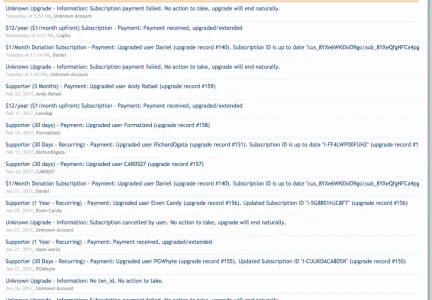

Over the past two month I've had a much higher than usual number of user subscription upgrades fail. I'm trying to figure out if it's a case of available funds or if there's a real issue here.
The most common issue is subscription payment failed with txn_type: subscr_failed.
Another is Unknown Upgrade: Information: No txn_id. No action to take.
Input appreciated.

A member messaged me regarding this, asking why their upgrade wasn't active. I haven't confirmed they have funds in their account but based on their message it sounds like they do, or at least a linked bank/card. My inclination here is that it's not processing correctly for some reason.
The member in question has two "Unknown Upgrade - Information: Subscription payment failed" errors. I'll try to get confirmation from them that the have available funds on their end.
Is there a guide for troubleshooting this? Anything I can do to test the upgrade system?

All that message is reporting is what PayPal is reporting to us. XF doesn't have any involvement in trying to take the payment, so there's nothing in your XF installation that could cause this. If you think the report is a false positive, you may need to check with PayPal directly.
