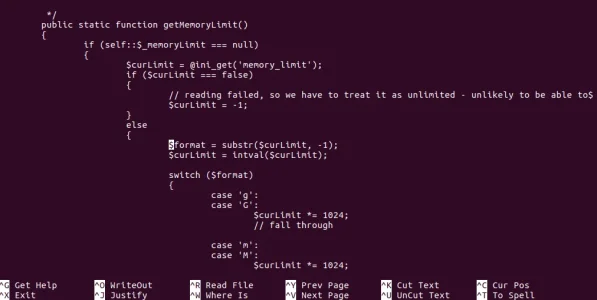

It is within this code block that I was suppose to change it correct?
PHP:
     * Gets the current memory limit.
     * @return int
    public static function getMemoryLimit()
        if (self::$_memoryLimit === null)
            $curLimit = @ini_get('memory_limit');
            if ($curLimit === false)
                // reading failed, so we have to treat it as unlimited - unlikely to be able to change anyway
                $curLimit = -1;
            else
                $format = substr($curLimit, -1);
                        $curLimit = intval($curLimit);
                        switch ($format)
                    case 'g':
                    case 'G':
                        $curLimit *= 1024;
                        // fall through
                    case 'm':
                    case 'M':
                        $curLimit *= 1024;
                        // fall through
                    case 'k':
                    case 'K':
                        $curLimit *= 1024;
            self::$_memoryLimit = intval($curLimit);
        return self::$_memoryLimit;
So I am not going crazy... this is live right now though I have downgraded back to 7.0.13. Also, confirmed that the php.ini change took as well with a phpinfo file outside of XenForo since it was down. When php is upgraded it is automatically restarted though I did a manually restart too just to make sure. No change in error.
