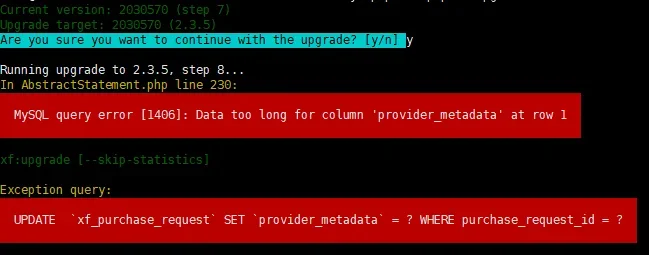

Here is the error I am getting in the CLI:
MySQL query error [1406]: Data too long for column 'provider_metadata' at row 1
UPDATE xf_purchase_request SET provider_metadata = ? WHERE purchase_request_id = ?
Let me know if you need any other information about this error.

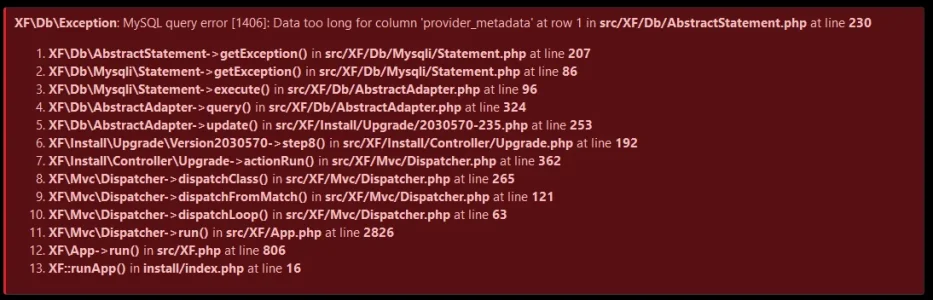

I've run the query in phpmyadmin, restarted the process and got the same error
XF\Db\Exception: MySQL query error [1406]: Data too long for column 'provider_metadata' at row 1 in src/XF/Db/AbstractStatement.php at line 230
  1. XF\Db\AbstractStatement->getException() in src/XF/Db/Mysqli/Statement.php at line 207
  2. XF\Db\Mysqli\Statement->getException() in src/XF/Db/Mysqli/Statement.php at line 86
  3. XF\Db\Mysqli\Statement->execute() in src/XF/Db/AbstractAdapter.php at line 96
  4. XF\Db\AbstractAdapter->query() in src/XF/Db/AbstractAdapter.php at line 324
  5. XF\Db\AbstractAdapter->update() in src/XF/Install/Upgrade/2030570-235.php at line 253
  6. XF\Install\Upgrade\Version2030570->step8() in src/XF/Install/Controller/Upgrade.php at line 192
  7. XF\Install\Controller\Upgrade->actionRun() in src/XF/Mvc/Dispatcher.php at line 362
  8. XF\Mvc\Dispatcher->dispatchClass() in src/XF/Mvc/Dispatcher.php at line 265
  9. XF\Mvc\Dispatcher->dispatchFromMatch() in src/XF/Mvc/Dispatcher.php at line 121
  10. XF\Mvc\Dispatcher->dispatchLoop() in src/XF/Mvc/Dispatcher.php at line 63
  11. XF\Mvc\Dispatcher->run() in src/XF/App.php at line 2826
  12. XF\App->run() in src/XF.php at line 806
  13. XF::runApp() in install/index.php at line 16
What can I do @Chris D
In previous cases I still believe customers had updated the wrong database or something along those lines. I'm yet to see a logical reason why the error would persist. That field should only ever contain a small amount of data that doesn't exceed 500 characters.
We'd likely need access to the forum database, the upgrade system and the file system so we can investigate.
