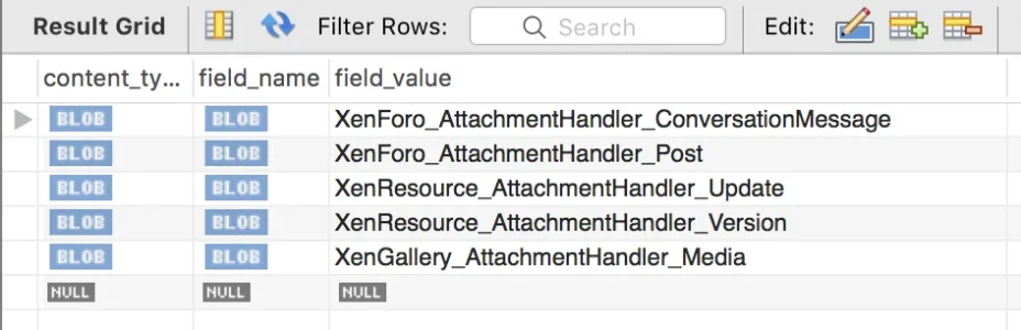

Can you run a query against your database?
SELECT *
FROM `xf_content_type_field`
WHERE `field_name` = 'attachment_handler_class'
What does that return?

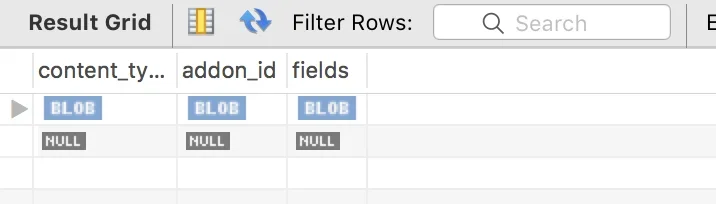

How about this query?
SELECT *
FROM `xf_content_type`
WHERE `content_type` = 'post'
