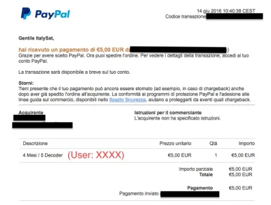

you can add when a user purchases through PayPal, in parentheses her nickname?
Yes to the second question. You are the second person who has asked for the nickname along with product name. I will add it to the next version.

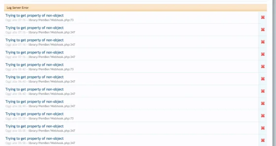

In my forum error log.
line 73:
#0 /var/www/vhosts/xxxx.eu/xxxxx.eu/board/library/PemBer/Webhook.php(73): XenForo_Application::handlePhpError(8, 'Trying to get p...', '/var/www/vhosts...', 73, Array)
#1 /var/www/vhosts/xxxxx.eu/xxxxx.eu/board/stripe_callback.php(24): PemBer_Webhook->process()
#2 {main}
line 347:
#0 /var/www/vhosts/xxxx.eu/italysat.eu/board/library/PemBer/Webhook.php(347): XenForo_Application::handlePhpError(8, 'Trying to get p...', '/var/www/vhosts...', 347, Array)
#1 /var/www/vhosts/xxxx.eu/xxxx.eu/board/library/PemBer/Webhook.php(99): PemBer_Webhook->log('error', 'Event Not Retri...')
#2 /var/www/vhosts/xxxx.eu/xxxx.eu/board/stripe_callback.php(24): PemBer_Webhook->process()
#3 {main}
Yes. This is fixed in 1.4.1. Basically this is because of bots visiting your site.
1.4.1 will be released shortly.
