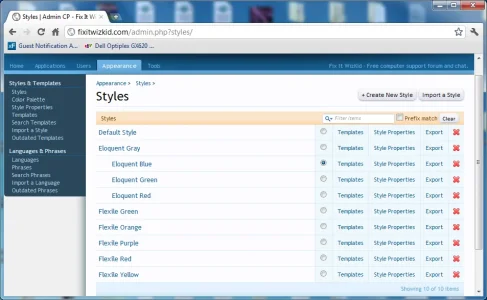

I then proceeded to uninstall the styles. All was going fine till i got to Flexile with the 5 child styles. I received this error....

The main style was removed but left the child's behind. I don't know if this is correct or not.

Ok, i had another 15 to add but i guess i best hold off on that then.

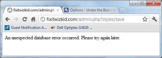

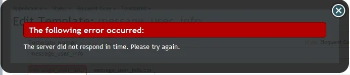

I now get this error after 30 seconds.
This only happens when i make an update to Eloquent Gray or Flexile Blue and they update the child's. The single styles save fine. What does it take to get past 30 seconds. :D
Nothing in the logs. What could i of missed?

Ok that is the javascript timeout from this file:
js/xenforo/xenforo.js
Rich (BB code):
			var ajaxOptions = $.extend(true,
				data: data,
				url: url,
				success: success,
				type: 'POST',
				dataType: 'json',
				error: function(xhr, textStatus, errorThrown)
					try
						// attempt to pass off to success, if we can decode JSON from the response
						success.call(null, $.parseJSON(xhr.responseText), textStatus);
					catch (e)
						// not valid JSON, trigger server error handler
						XenForo.handleServerError(xhr, textStatus, errorThrown);
				timeout: 30000 // 30s
			}, options);
You can edit that file to increase the timeout. Then refresh the Admin CP to make sure you have the latest javascript. That might fix your problem.

Thanks Jake that nailed it.
timeout: 300000 // 300s
Eloquent Gray + 3 child's : 32 seconds
Flexile Blue + 5 child's : 58 seconds
Good man (y)
