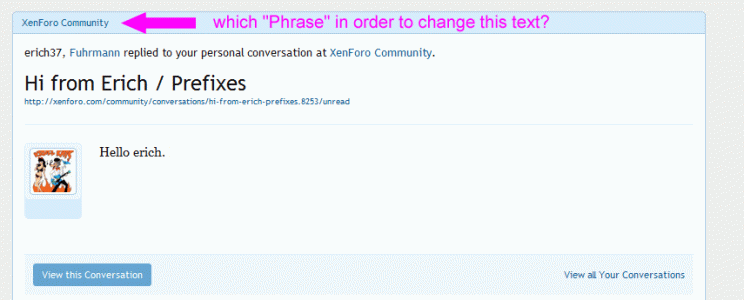

no, {title} is the thread-title or the conversations-title.
I am looking to remove the {board} in the "personal conversations" Email.
Edit:
I guess you are right, but I do not want to change my board-title just to get the Email-title changed. Hopefully we can get a separate Phrase in order to change the Email-title.

no, all of those phrases do not include nor change the "Board title" as shown in my screenshot a couple posts above.
