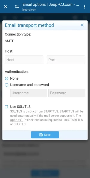

So why is the only option in the XF Admin panel PHP? Couldn't there be automatic SMTP set up in XF?
xf admin panel has four different options for emails!

10,000 emails divided by 6 months is only about 56 emails a day. According to my account I am using about 500 a day! My server limit is 300 a day. Amazon info says 200 a day. So I know I need to switch to SMTP but maybe it would be easier to just switch to SMTP with the server email for now. I've asked them how to do that and they gave me instructions for wordpress. Told them I don't have wordpress and they gave me instructions to set up PHP Mailer. Isn't that what I have already?
Ok I'm no further on. Can anyone explain to me how to convert a PHP email to PHP Mailer and convert to SMTP?
first step would be to decide on an email service provider like amazon ses or any of the others. i suggested zeptomail few mails ago.
then you would need to create an account, add your domain, configure it as suggested (mx/dkim etc). get through the verifications.
once you can send a mail through your domain from such a service, you are all set to configure it as smtp provider in xenforo backend.

Thank you. So if I convert to zeptomail, is that automatically SMPT? And then just the back end in XF to set up?
smtp is basically a protocol for sending emails. in general sense, smtp here would refer to a third party service which you use to handle your emails. so once you have configured such a service, and you can send test mails through them, those services give you certain information like server, username and password. you just need to enter these details in xenforo email settings to tell xenforo to use that service to send mails in the future. it's nothing complicated. the hardest part is to configure the external service. you do not convert anything. you just pick a service providing transaction mail functionality, spend a bit of time to setup your forum domain on that service and get the details you need to enter in xenforo backend.
