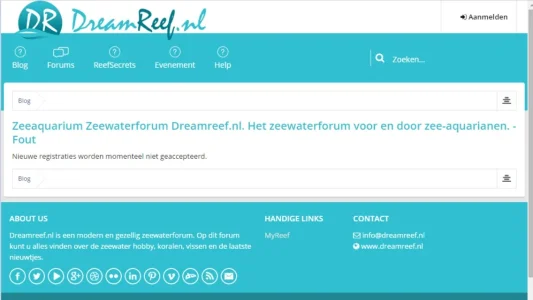

I have a problem that comes up often. When a new user want to registrate the software gives them a screen that new registrations are not accepted at this time.

The screenshot i attached is a shot that i got from a new user that had the problem.
It's in dutch but it says that new registrations are not accepted at the moment.

It could be spam related indeed. I searched for the settings and found the settings on the screenshots. The amount of flags is 3 and the other one says it requires a admin to approve.
But i found another setting but i don't know the translation for it. It's the setting you give someone you want to "irritate" and not give a ban yet. So they get al sort of problems with the forum. I think you call it discourage.
There is a setting in "user registrations" that allows the admin to reject discouraged ip adresses and give the the screen "new_registrations_currently_not_being_accepted"
So it seems to be a problem like you guys said with something like this or spam.
