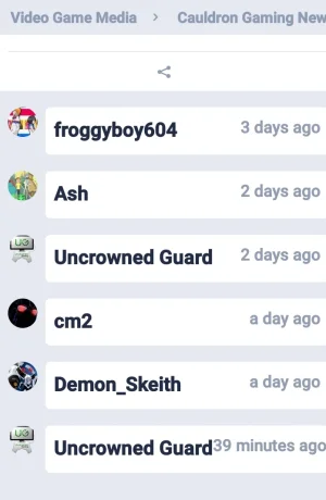

I cannot even see threads on your app.
After debug with your app I can give conclude some add-ons in your site has rendered HTML which not support in app.
Example:
<span data-s9e-mediaembed="youtube"><span><iframe allowfullscreen="" scrolling="no" allow="autoplay" style="background:linear-gradient(0deg,rgba(0,0,0,0) 0,rgba(0,0,0,0) 72%,rgba(0,0,0,.04) 79%,rgba(0,0,0,.1) 83%,rgba(0,0,0,.25) 88%,rgba(0,0,0,.67) 100%),url(https://i.ytimg.com/vi/n2-EfRgR34E/hqdefault.jpg) 50% 50% / cover" src="https://www.youtube.com/embed/n2-EfRgR34E" data-s9e-mediaembed-c2l="youtube" data-s9e-mediaembed-c2l-oembed-id="n2-EfRgR34E" data-s9e-mediaembed-c2l-src="https://www.youtube.com/embed/n2-EfRgR34E?autoplay=1"></iframe></span></span>
To support best for app it's should only return as follow:
