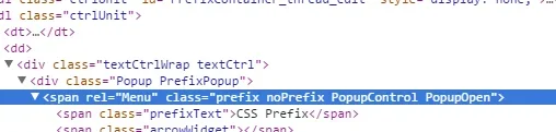

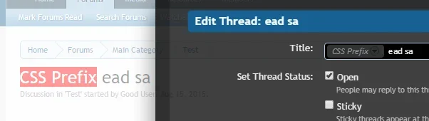

Minor issue with the latest version.
If you have a custom CSS prefix defined the class for that is not added to the thread edit overlay title. It just appends noPrefix instead of my custom class 'cssPrefix' making it impossible to style.
With Multi Prefix disabled, it works as expected.
