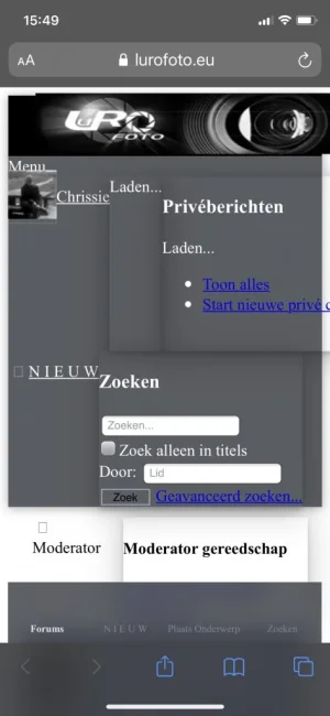

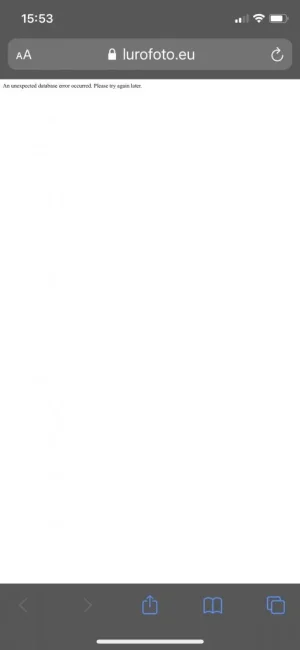

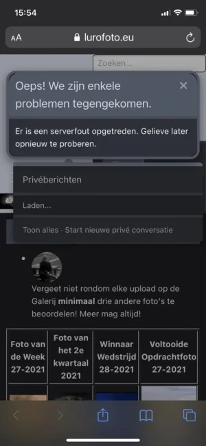

My host says That i did not close the MySQL connections properly while I'm not even aware that I seem to have more that 30 MySQL open connections at the same time. But when I do I see messages like in the attachments of another member. On a computer as well, on Mac, on iPad, with all kind of browsers, it just happen. While opening the website, switching pages, opening a photo, sending comments, it just happens. Refreshing the page will help. One time or maybe five times.
It's very frustrating.
My host recommended I should transfer from shared hosting to VPS which I can not afford.
Who is familiar with there database and server errors and who has the solution?
