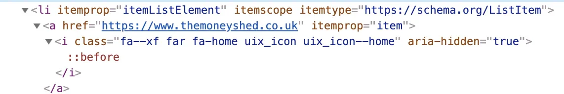

According to the Structured Data Testing Tool it is this:
Your "Home" icon breadcrumb doesn't have the name metadata. I'm fairly sure that might be an issue with your style as, by default, the home breadcrumb is made up of text and it includes the name metadata.

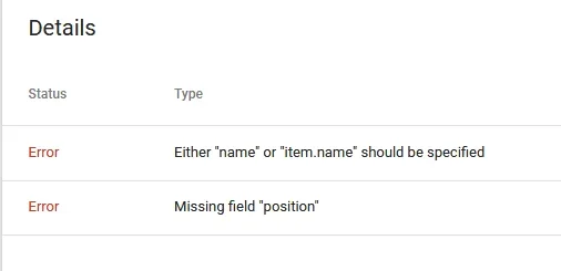

I'm getting both errors listed above plus a 3rd.
Error Either "name" or "item.name" should be specified
Error Missing field "position"
Error Missing field "item"

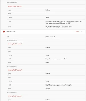

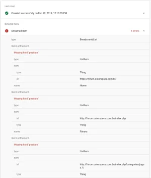

Google reported 18 affected URLs for me (insignificant number, as we have close to 500k topics). Example:
URL inspection returned these errors:
