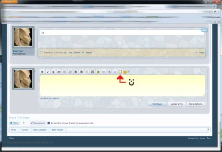

A ok now I did some tests.. Same issue here:
While using the WYSIWYG-Editor for a reply, you can't tabbing to post reply... (I thought of a tabstopp but forget about that ;) )

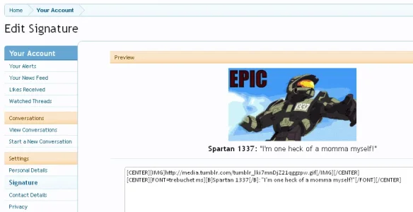

Suggestion? Drop down for colors like the WYSIWYG editor? Other than that is works good o_o
Edit: Anyway to add this to the signature page?
It's automatically added to any instances of the plain text editor.

Where would I add it in this?
<xen:title>{xen:phrase edit_signature}</xen:title>
<xen:require css="account.css" />
<form method="post" class="xenForm AutoValidator Preview"
    action="{xen:link 'account/signature-save'}"
    data-previewUrl="{xen:link 'account/signature-preview'}">
    <dl class="ctrlUnit fullWidth">
        <dt></dt>
        <dd>{xen:raw $signatureEditor}</dd>
    </dl>
    <dl class="ctrlUnit submitUnit">
        <dt></dt>
        <dd>
            <input type="submit" name="save" value="{xen:phrase save}" accesskey="s" class="button primary" />
            <input type="button" value="{xen:phrase preview}..." class="button PreviewButton JsOnly" />
        </dd>
    </dl>
    <input type="hidden" name="_xfToken" value="{$visitor.csrf_token_page}" />
</form>
Sorry that I'm not too well with Xenforo code. It looks interesting though.
