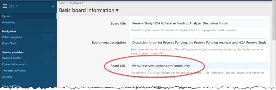

I see, I think I know the problem. It happens to me all the time when I use my localhost setup and that is the first thing to do.

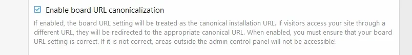

Disable this and see if it works:
ACP->Options->Basic Board information
Note: It was the Board URL which needed to change in ACP.

As above, change the board URL to your temporary domain

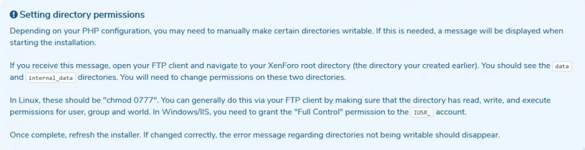

Also set the directory 'data' and the directories within it to 777
I checked permissions for the existing data directory and they are set as follows:
Same permission are set on the new data directory.
Why do you say set to 777 as 755 seems to work now?
