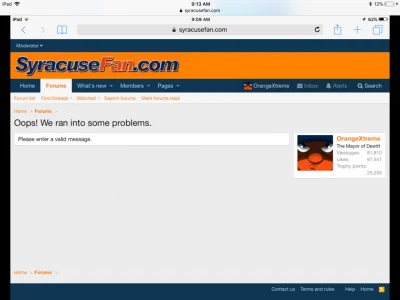

This is what happens when the post reply button at the top of the page is hit. The post and reply box never appear.7E764370-AE1D-4C77-9DCB-322D37611142.webp

Thanks for the replies. The issue was that some visitors using older iOS devices don't see the post or reply form. They can't post or reply, but can send direct messages. The screen capture above was reported by one user ("Oops! We ran into some problems").
