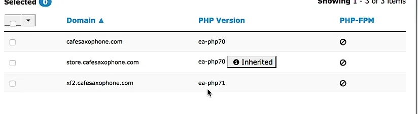

What version of PHP are you using?
Can you look at your PHP info and report all of the info from the mysqli section and, if present, the mysqlnd section?

If you can get a setup in position to start an upgrade (1.x DB, 2.x files, upgrade not started), I can do some testing to see if I can resolve the issue.
If that's an option, I'll need FTP details (and ACP access details to start the upgrader). Please submit those via a ticket (referencing this thread).
Thanks MIke
I've been doing some testing and did manage to get it to upgrade, I'm just doing another test to see if I can pinpoint the issue and see how to replicate it.
If I can do that I'll let you know.
