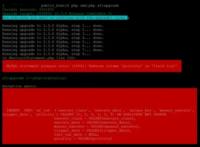

Tried upgrading 2.1.2 to 2.2.16-Patch-2 and then to 2.3 RC2 but got these errors:
Tried a couple things and then got this error on the next upgrade attempt:

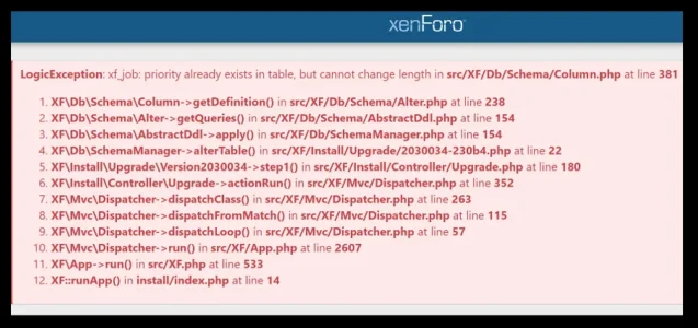

LogicException: xf_job: priority already exists in table, but cannot change length in src/XF/Db/Schema/Column.php at line 381
[LIST=1]
[*]XF\Db\Schema\Column->getDefinition() in src/XF/Db/Schema/Alter.php at line 238
[*]XF\Db\Schema\Alter->getQueries() in src/XF/Db/Schema/AbstractDdl.php at line 154
[*]XF\Db\Schema\AbstractDdl->apply() in src/XF/Db/SchemaManager.php at line 154
[*]XF\Db\SchemaManager->alterTable() in src/XF/Install/Upgrade/2030034-230b4.php at line 22
[*]XF\Install\Upgrade\Version2030034->step1() in src/XF/Install/Controller/Upgrade.php at line 180
[*]XF\Install\Controller\Upgrade->actionRun() in src/XF/Mvc/Dispatcher.php at line 352
[*]XF\Mvc\Dispatcher->dispatchClass() in src/XF/Mvc/Dispatcher.php at line 263
[*]XF\Mvc\Dispatcher->dispatchFromMatch() in src/XF/Mvc/Dispatcher.php at line 115
[*]XF\Mvc\Dispatcher->dispatchLoop() in src/XF/Mvc/Dispatcher.php at line 57
[*]XF\Mvc\Dispatcher->run() in src/XF/App.php at line 2607
[*]XF\App->run() in src/XF.php at line 533
[*]XF::runApp() in install/index.php at line 14

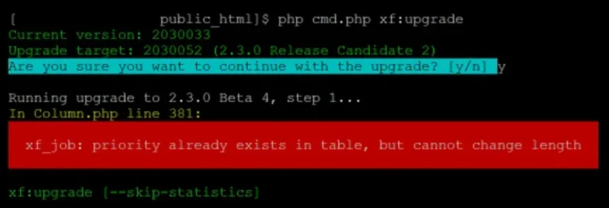

Went back to command line upgrade and got this error:
Any suggestions?
