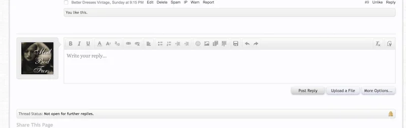

I have the ability to lock threads and it says not open for further replies but members are still allowed to reply. Is there something I need to change?
Thank you in advance.

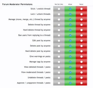

Here's what I see for our non mod group permissions -

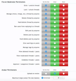

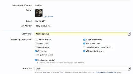

and here's what I see for my status. Do I have anything listed incorrectly here?

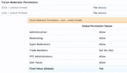

Ok, so I chose the option analyze permissions. When selecting my user name this is what I saw -

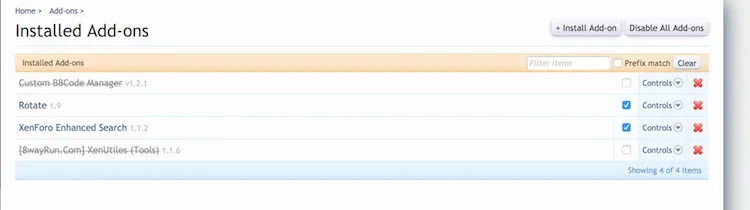

Lastly here's what I show for our add ons -
If the analysis for the node is the same then I don't see how they can post in a locked thread.

Note your main user group is set to "administrative". That may be affecting things. All users should belong to the "Registered" user group and any other user groups should be secondary user groups.
So, I'm guessing the main user groups for all other members are following the same method as yourself.
Of course I could be totally wrong too. ;)

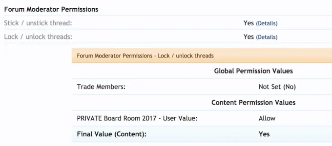

Ok, so I analyzed a trade member who is on the board but not a moderator's permissions for the board room. I am not sure what this means. I do see locking/unlocking threads is not allowed for her however below I see something below that says PRIVATE Board Room 2017 - User Value: Allow Final Value (Content): Yes.
Does that mean that outside of the board room forum she is unable to lock/unlock threads but outside of the board room forum she is not?
Ok, so it must that way for all the users in that forum. When I go to my node permissions for that board forum and click trade members the option inherit is chosen for lock/unlock threads. When I choose each member of the board forum same thing; inherit option is chosen for the lock/unlock threads. Do I need to do something else to change it because it seems maybe that they are inheriting that from me? if I understand correctly.

Issue resolved!
Globally users did not have permissions to lock/unlock threads. User group permissions said all users within did not have permissions.
10 users were added to the group which was set to private node and the group's permissions as a whole said users were not allowed to lock/unlock threads.
When checking each user's group permissions individually, 3 out of 10 users entire forum moderator permissions were set to allow which included the lock/unlock threads permissions.
