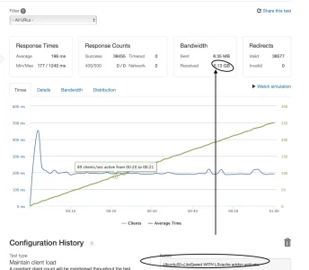

Hello,
LSent with LScache addon outgoing traffic increased huge. pls check (both servers (nginx and LS) at different but the same VPSs by DigitalOcean 2vpu+2ram). tested the same domain with copy of DB and files (just from different droplets)
test by loader.io: 1 to 250 online users per 1 minute.

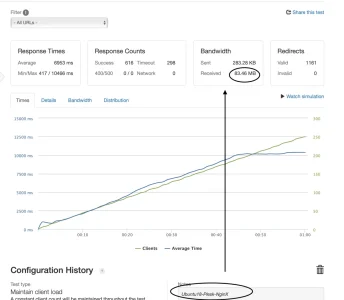

1. nginx - normal traffic usage

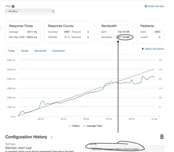

2. LiteSpeed without LScache addon: increased traffic usage in 5 time
and extra heavy!!!! 3: LS with activated LScache addon - traffic was increased in 62 times!!! WTH? this is normal?!
Also i don't believe in 200ms responses...

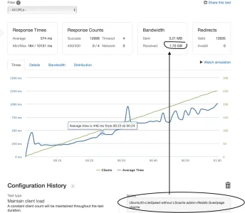

Hey, made the same test but with this config:
LS without LScache addon + Guestpage cache by Redis via Xon redis addon.
still traffic increased but in 20times now. and response time now looks more real.
Seems like with any type of caching we have 20-50times increased outgoing traffic? or this is some error with server on my side?

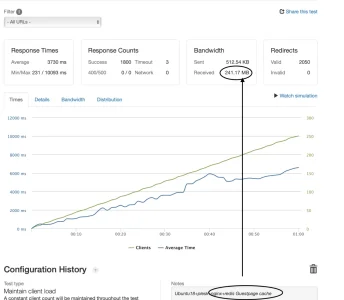

and one more test
nginx + redis cache for Guestpage via Xon reddis addon
slightly increased outgoing traffic vs non cache on nginx.
ok. waht we have?
test type: A constant client count will be maintained throughout the test duration. (0-250 in one minute)
droplet: Digital ocean 2cpu 2ram
1. nginx without caching: traffic: 80mb, response time: 7000ms
2 nginx with guestpage reddis caching via Xon redis addon: traffic 240mb, respose time: 3700ms
3. LS without caching: traffic 360mb, respose time: 2500ms (seems the to best result in overall)
4 LS + own guestpage cache addon: traffic 5136mb, respose time: 200ms (something wrong here...)
4 LS + redis guestpage cache via Xon redis addon: traffic 1700mb, respose time: 570ms (still very increased traffic)
my question is: where is my error with LS server setup (most settings is default) or this huge traffic with any type caching for LS is normal?

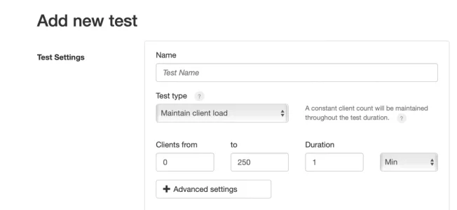

What software are you doing these tests with?
I also have the VPS of digitalocean 2vpu and 2ram

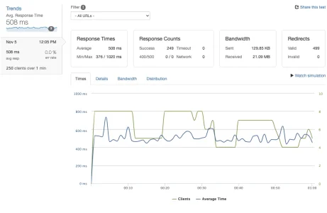

maybe I did a bad test, can you tell me what configuration you are placing?
