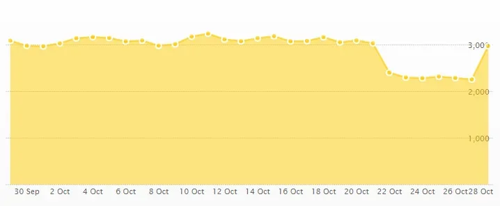

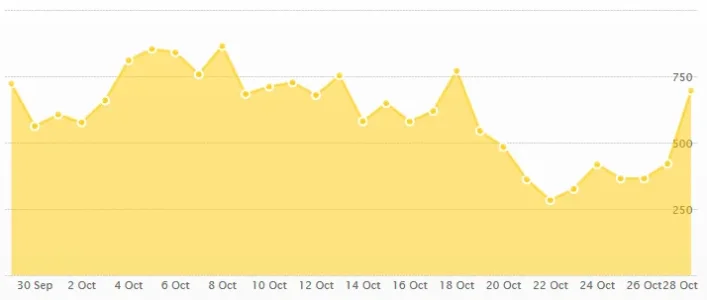

Having run 1.3 since launch with link proxies on, I have some data on Skimlinks. The guys there have been in touch to ask we test the system by turning link proxies off.
They are saying that our Skimlinks revenue is significantly down and they are confident this relates to link proxies interfering with Skimlinks in certain browsers. By turning link proxies off for a while, we can confirm one way or the other.
The Skimlinks team are looking into the situation today to get some firm information.
Meanwhile other Skimlinks users should be aware that there is likely a problem using link proxies and Skimlinks together.

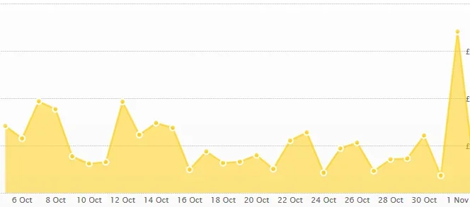

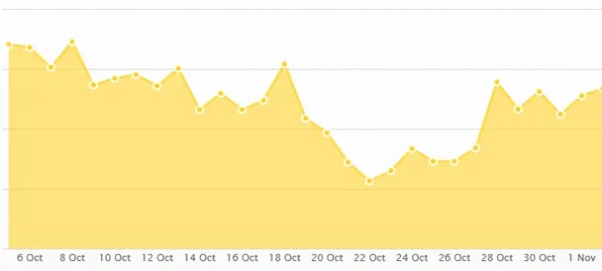

Had a message from Richard at Skimlinks who I don't think will mind me posting here:
We decided to leave it overnight so we could have more eyes on the clicks as things progress. We've just pushed the change this morning.
We'll keep an eye on things throughout the day and please don't hesitate to get in touch if anyone reports anything out of the ordinary.
