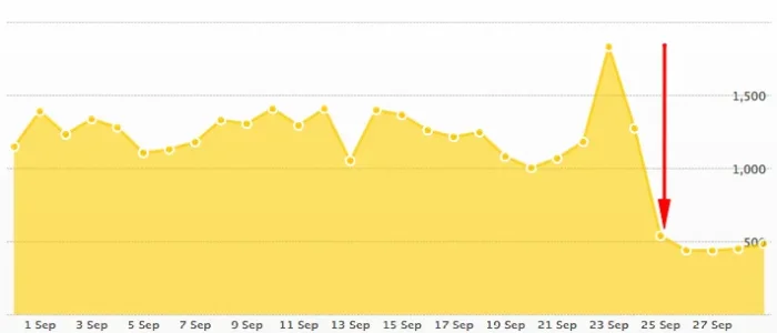

Yep, as per my post in that thread. It basically wiped out the whole of February's income from Skimlinks by having it enabled.

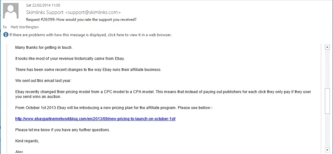

And regarding the eBay Partnernet:
It is true that eBay was a huge source of income and this has seized completely after their recent changes. Their affiliate program (https://www.ebaypartnernetwork.com/) simply does not make sense any more.. :-(
