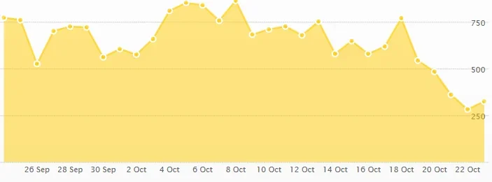

I've never used link proxy and upgraded all my sites to 1.5.2 late in the evening on 20th Oct:
So, yes, confirmed outgoing link count drop for me (visitor stats normal in GA and no dramatic change in Adsense).

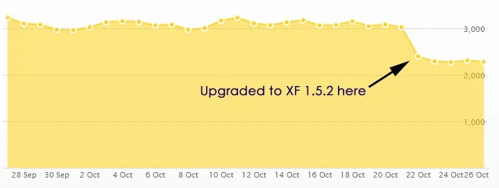

Click counts still way down - any news from XF or Skimlinks as to why this is happening? (although it does seem to have coincided with changes in XF 1.5.2 - what changed?)

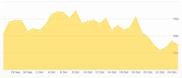

We have the link proxy disabled, Chris, and we have also experienced a decrease. It's about 24%.
This applies to the Skimlinks technology (not Skimwords which seems to be unaffected) and it amounts to a loss of approximately £400 every month.
So it's a serious problem which needs addressing ASAP.
