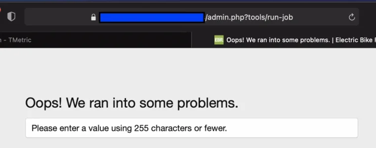

Hey There, having problems with rebuilding the link index. The rebuild job runs for a long time, and then it always crashes and shows the error message "Oops! We ran into some problems. Please enter a value using 255 characters or fewer." I have tried checking the box to delete the index before rebuilding, and this makes no difference.
Nothing is outputted to the server error log. Can you give me any suggestions?

The add-on is enhanced to allow replacing a broken tag with another tag. For that, use the option "Delete/Replace Tag". You can provide any text/BB Code as a replacement, and if you prefer keeping the URL in some form, just use {link} as a placeholder, e.g. [DMLURL]{link}[/DMLURL] will replace the broken link with BB Code DMLURL wrapping the link.
This release also fixes an error during tag indexation, for tags with attributes longer than 255...

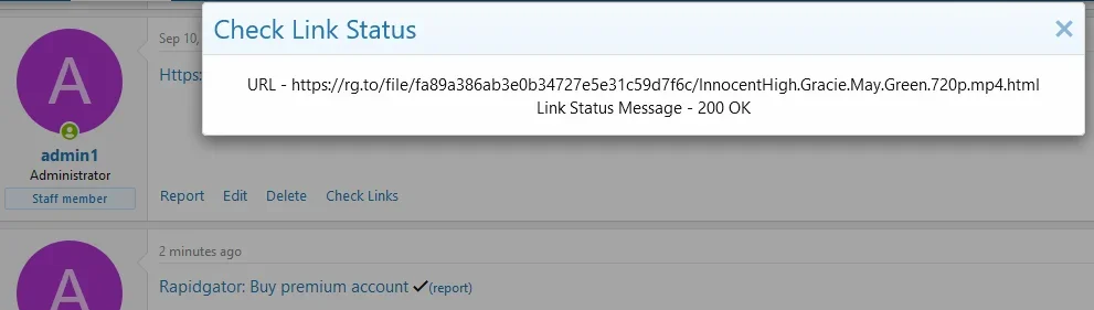

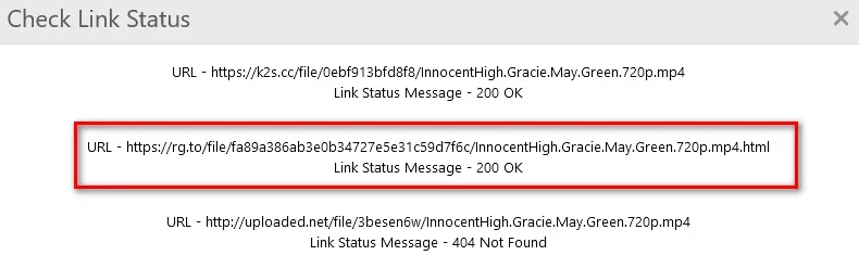

@AddonsLab Does Demo site removed? We need test one URL from rapidgator.net/rg.to because link are dead 404 File not found but Link Checker addon report 200 OK.
Whenever you want to send us a link to check, please send the text. We have to type this long URL by hand to check it, which is not that optimal.

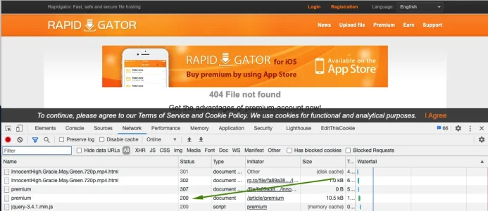

The server returns redirect and 200 OK status response:
As you already know, we can't verify that the link "works", we just depend on information the server returns, and if a file is not found the server should return 404 Not Found response. Anyway, we may be able to support this specific domain by checking their page's HTML. We will give it a try and release an update if it is possible to support.
