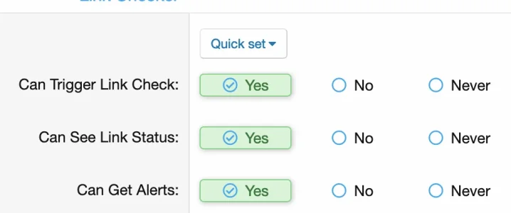

(2) My test user has permissions
When he posts a dead link it shows as expected with x and report link.
But he gets no alert and when pressing report, I (admin) don't seem to get a report.
So how is this meant to work, something else needs configuring maybe?

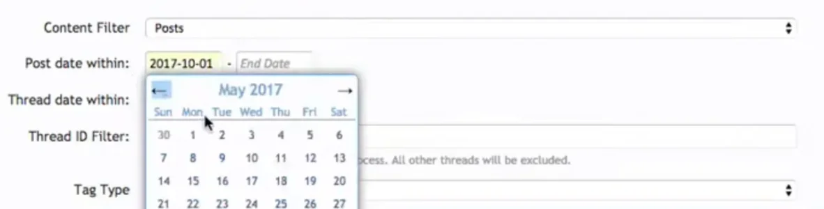

(3) The video (which is helpful thanks!) shows a date range. How do I get to view this?
