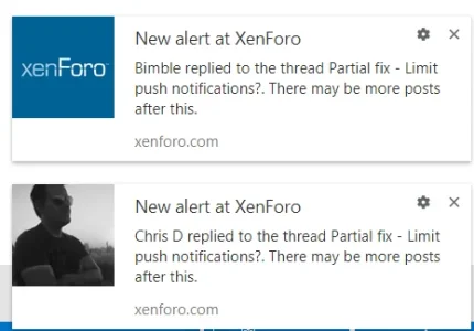

I'm still not sure if I'm misunderstanding how it should work or if it's a bug.
  • I have notifications enabled on Chrome on my work laptop.
  • This was shut down and off all weekend.
  • Over the weekend I browsed XF on my home laptop, iphone, etc.
  • Turning on my work laptop on Monday morning (now) and opening Chrome, I get a load of notifications from XF.
  • Screenshot shows two for the same thing but I received something like 10 notifications for different threads, types, etc.
  • I load xf.com and I have no alerts (as expected as I saw them all over the weekend)
  • Is this expected?

It is expected potentially due to browser caching of the service worker and it still being loaded into your browser.
We don’t envisage we’ll need to change the service worker very often, but when we do it may take a while for the changes to take effect.
Logging out and back in on the laptop may help it on its way and once you’ve done that I’ll try and trigger the correct behaviour for you.
But even then it still might not work depending on whether the service worker gets the changes or not.

The laptop was off all weekend and I just logged on. Do you mean logging out and back in again in addition to that?
