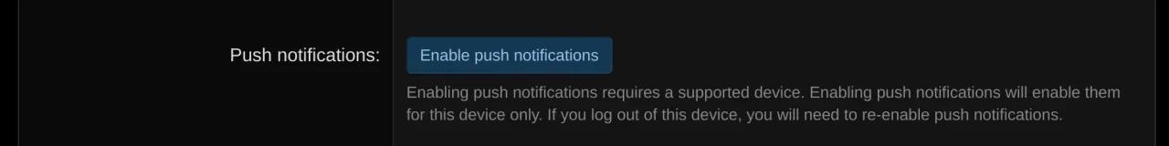

Push subscriptions are scoped to an origin/domain, so users will need to resubscribe. I'm not sure off-hand why they wouldn't be prompted again when visiting the new domain. Does the option show up under account preferences?

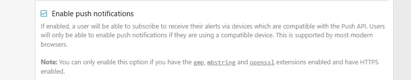

Check your new server's PHP settings to make sure the GMP extension is installed and running, especially if you see related errors in the forum's error log.
If the option doesn't appear in preferences then it points to push notifications being disabled, the user not having permission to receive them, or the environment not supporting it (ie. the request is considered insecure).
GMP is enabled. I merely created a new domain on the server and asynced all the files, copied the database to a new one, changed the database name/password.
