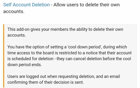

I would never use this add-on as I feel that this is an admin only function, not even a mod should be able to make this decision. It opens up the forum to abuse especially, as others have said.
Self delete should be an admin only function?
