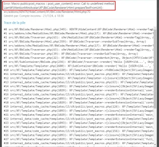

MiniMentions is working in XF 2.3 beta 5. But I get the error below.
I made sure the Html.php is exactly as what's found in the latest download [LiamW-MentionMiniAvatar-2.0.0.1].

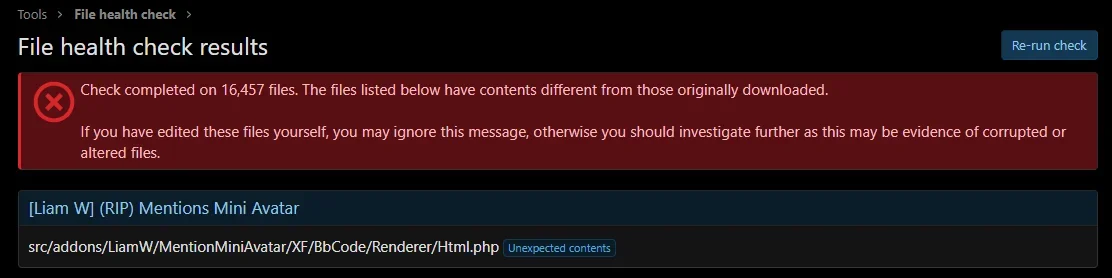

Text for keyword searches->
File health check results
Re-run check
Check completed on 16,457 files. The files listed below have contents different from those originally downloaded.
If you have edited these files yourself, you may ignore this message, otherwise you should investigate further as this may be evidence of corrupted or altered files.
[Liam W] (RIP) Mentions Mini Avatar
src/addons/LiamW/MentionMiniAvatar/XF/BbCode/Renderer/Html.php

EDIT:
I deleted the hashes.json per this thread and no longer get the error.
This doesn't fix anything. It's more like a permanent way of ignoring the error (I guess).

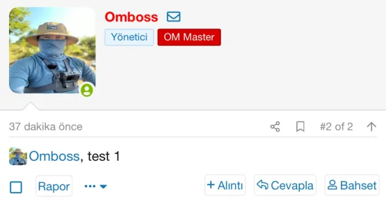

Here a quickfix for XF 2.3 ... change in the above mentioned file the line 86 from
$avatarHtml = $this->templater->fn('avatar', [
to
$avatarHtml = $this->templater->func('avatar', [
to

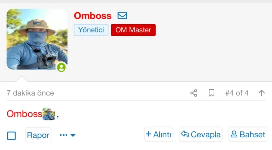

thank you for that, it worked, but the mini avatar comes out at the end of the username, what do I need to do to get it at the beginning of the username?

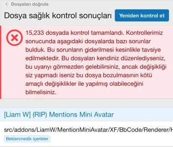

Oh, okay. The source of this problem was this plugin; MMO Mentions User Rich Formatting. Everything is normal now.
It only gives a file error. It can be ignored until the plugin is updated
