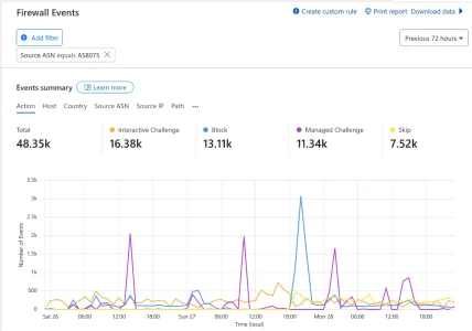

• Many of the attempts came recurringly from the same IP addresses
• most of them belonged to hosting providers in Russia
• apart from that there were a limited but recognizable amount of VPN endpoints in various countries and occasionally some from countries like China, India, Indonesia, Taiwan, and - more rarely - from the US, UAE, Aegypt and Ukraine

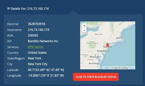

Coming back to the unwanted bots: I did the same with the unwanted bots from the list "Known Bots" created that did not follow the robots.txt (btw. many claimed on the website they would respect the robots.txt but in fact did not. Various SEO-companies notoriously but also i.e. the Chat GPT training bot - or a bot using this as it's user agent). A very special case is Meta's "facebook external hit" bot: It claims to respect the robots.txt most of the time but sometimes not. It claims to have the purpose of creating previews for content from your forum shared on facebook - but at the same time to be used for "security checks" and other purposes - so it even does not rule out to be used for training Facebook's AI model. To get this needs sorrowful reading - this thing seems indeed to be a trojan horse. Other companies have different bots for different purposes.
To get those IPs the bots are using I had to grep them from the web.log of the server using the user-agent as filter criteria (as the Kown Bots add on does not provide the IPs). Some of the serious businesses that use bots do tell the IPs or IP ranges their bots use on their webpages. This comes in handy as this way you can block it out completly while with the approach via the web.log you only get the IPs one by one which is a bit annoying. BTW: A lot of the companies that send bots to your forum do not like bots on their own websites - they use cloudflare's "I am a human check". Double standards I'd say - and a clear hint that you do not want THEIR bots on YOUR website as well..
An interesting thing in that respect were the "gerneric library based bots" I mentioned earlier. It turned out that they were quite massive in the attempts to scrape forum content and that many of them were using IPs from the big cloud providers. A lot of attempts came from AWS, mainly China-based, but also Microsoft, Digital Ocean and even Oracle. Plus again loads from Russian providers. And they were mostly using multiple IPs from the same network blocks of the ISP/hoster in question.
So again I took advantage from being a small forum, pushed the IPs in question into whois and simply blocked the whole network block the IP belonged to via .htaccess in most cases. Again a bit of a dangerous game, especially with providers like AWS as many companies are using their services - so there is danger of collateral damage, but so be it.

These measures collectively brought down unwanted traffic and behavior massively - at least for the moment. This will need constant readjustment of the robots.txt and the .htaccess but in general seem to be a success. How demaning the adjustment needs will be stays to be seen. Basically I followed a bunch of patterns:
• user agent
• behaviour
• geographical location
• kind of ip-adress (dialup, hoster, VPN, cloud provider, mobile)
In some cases all 4 patterns hit, in some less than that. And it turned out that many of the IPs caught in one of the Spaminator add ons also did scan for wordpress weaknesses or grabbed content. BTW: While IP V6 addresses did turn up from time to time the vast majority was IP V4.
I do have no proof but the impression that most of those requests probably came from just a hand full number of different persons (or rather criminal organizations), using changing IP addressess over time. Too similar were the patterns during registration or the URLs they crawled automatically. And it seems that most of them have their source in Russiain the end - a country notoriously famous as a common and pretty safe home for all kinds of internet crime for decades already. There are other sources as well, but in comparison these are few.
