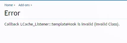

I tired can't install the addon, I've got keep error.

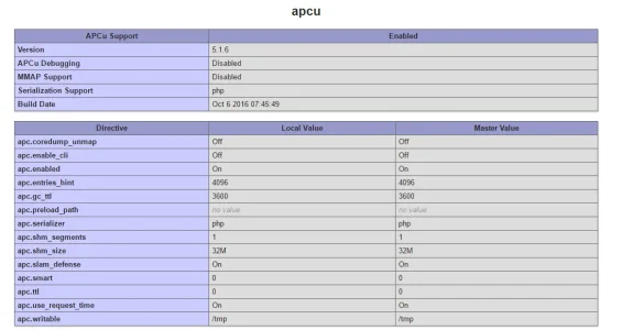

I have it working on my Windows 2008 server using Xampp and PHP 7.0.13 so far so good! Took me a little while to find a latest version of APCu... Hopefully everything looks ok with the values. I put the information in the library/configScreen Shot 01-14-17 at 11.10 AM (2).webp
I have it working on my Windows 2008 server using Xampp and PHP 7.0.13 so far so good! Took me a little while to find a latest version of APCu... Hopefully everything looks ok with the values. I put the information in the library/configView attachment 146344
Might have to mention that you should definately increase the amount of memory APCu can store :) I set mine to 128mb and do not cache sessions.
Is there a list of settings I can load onto my php ini?
You should probably go through and figure out what each setting does so you don't accidentally crash PHP but here's what I use:
