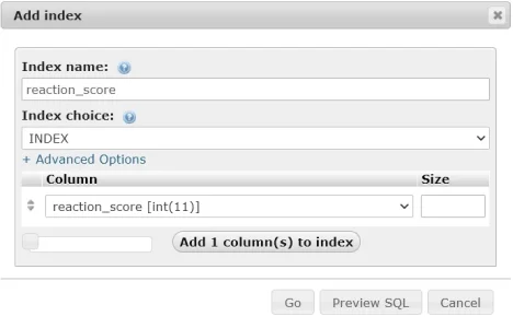

@Xon thanks so much that's so useful, I knew I would be doing silly things!
Is it an easy fix to just add an index for reaction_score and thread_id like this?
I did try a limitbypage and limit but I must have done something wrong as it didn't seem to reduce the dataset, if implemented correctly would it be a big performance improvement?
You will need to experiment to see if an index on reaction_score or reaction_score, thread_id or thread_id, reaction_score work best. (Column order can matter!)
Yes, but it is dependent on an index being used to correctly limit the results without sorting first.
I could be wrong, but I'd expect an index on reaction_score, thread_id to yield better results than thread_id, reaction_score if the query is always for values >= 100 as that seems to be a pretty high number (to me)
