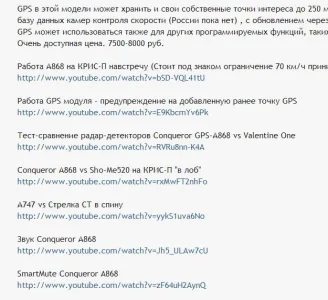

Hi. After import from vB 3.8 all youtube links in messages haven't converted into window look. It could be done if you edit and save message without editing. Could anyone suggest what can I do with this?
Example:
I can't see the BB code in that screenshot, but I assume it's a plain URL tag with no option.
