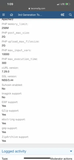

Negative. I will in a minute and I’ll report back. To be honest, I gotta check how to do that first.I agree, that is a non issue. Did you happen to check your server environment report?
Check in your info.php for:Negative. I will in a minute and I’ll report back. To be honest, I gotta check how to do that first.
EXIF Support enabled EXIF Version number goes here Supported EXIF Version number goes here Supported filetypes JPEG, TIFF
